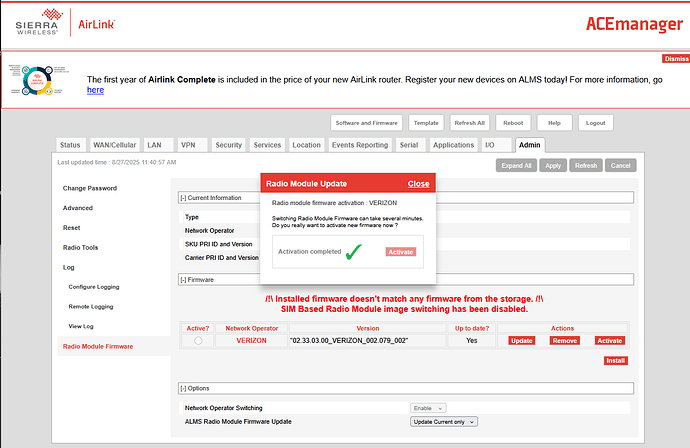

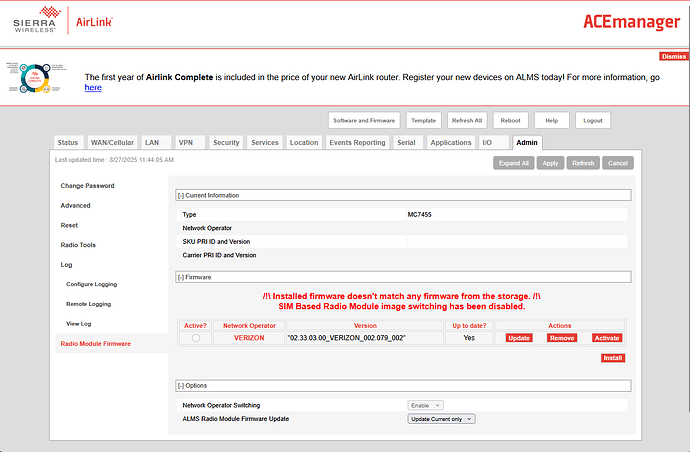

The radio firmware in a RV50X modem will not activate. I have tried reloading the most up to date radio firmware multiple times which is successful every time. After the firmware is uploaded, I have attempted to activate the firmware which shows as successful immediately afterwards. Upon checking the firmware status, it still shows as not active.
Also the Radio Firmware version shows as RMNode and Radio Module Identifier shows as NOT SET when the button “Software and Firmware” is clicked,
The version of ALEOS is 4.18 which is the latest.
I would like to know how to activate the radio firmware so the cell modem will properly connect to the Verizon Network.
See the screen caps below.

Did you ever find a solution for this issue? I have a remotely deployed RV50X with very similar symptoms. It had been working fine for many months and then suddenly I was unable to connect to it over the network. When I visited the site and connected to it via ethernet, I found the same error as in steven’s screenshot above saying that the installed firmware not matching any firmware from the storage. I also found that the log file is full of lines reading “ALEOS_CELL: Radio Enumeration Failed…“ and “ALEOS_FIRMWARE_rmswitchingcheck: (qmisdkhelper) Radio module is disconnected“.
I have tried activating Radio Module Firmware for a couple of different Network Operators (Verizon, ATT, Generic), and got similar results to steven where activating the firmware shows as successful but checking the firmware status shows that the new firmware is not actually active.
I have also tried updating/reinstalling the Radio Module Firmware, updating/reinstalling ALEOS (4.18.1.002) and resetting the device to factory defaults. None of the above resolved the issue or changed any of the symptoms.
