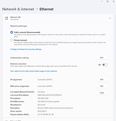

  1. When accessing the RV55 via USB, do you see any interface appearing like the one in the attached image?

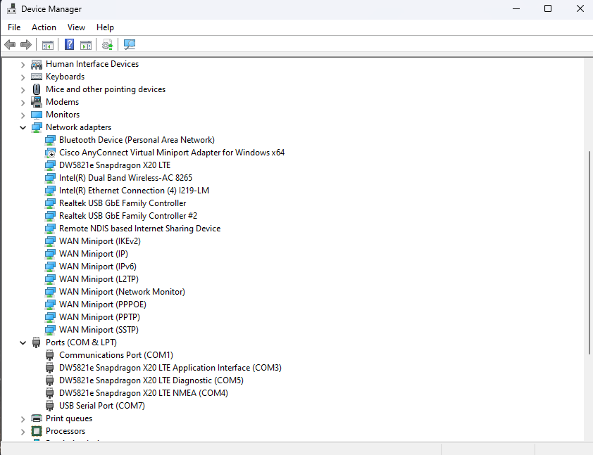

  2. Please share a screenshot of the Network Adapters and Ports sections under Device Manager with me.
  3. If it shows an IP address like the one in my screenshot, then when you access https://192.168.14.31:9443/, what screen appears? Please share a screenshot with me.

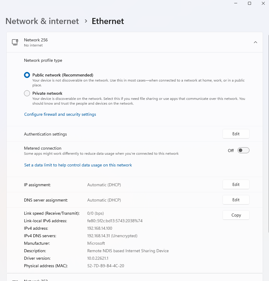

I left the RV55 plugged into by laptop overnight and when I came back in this morning, I tried to access the Ace Manager UI and it came up surprisingly. So I’m not sure what the issue is, but it seemed to somehow work after being connected after I long time.
I have another modem as well that has the same problem but it’s a RV50X. See the attached screen caps below. i might come up after waiting a while, but that’s not normal considering that soon after the modem is plugged in I can ping both the USB IP address and the Ethernet IP address.
