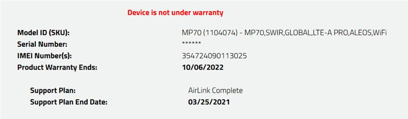

354724090113025
N683110041021035
@jerdung This is just one of them, I have aprox. 200 units with the same problem.
Hi @thp,
After checking, it appears that your AirLink Complete has expired.
Could you please help to check again about the AirLink Complete of the device? If you have any questions/concerns, please let me know.
