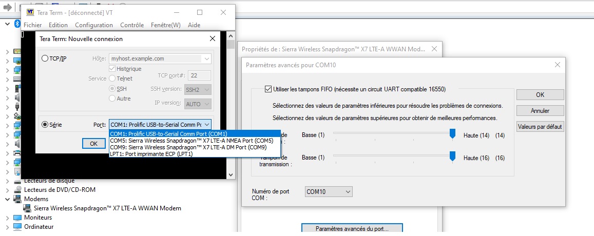

My PC displays this; however, I am unable to connect to the 4G network. Could you help me?
You can use Tera Term to connect to that port. Then, please share with me the output of the following commands to check the firmware version and network status:
The modem is on port 10. When I launch Tera Term, it does not see it. However, it sees two other ports. I have uninstalled and reinstalled the drivers, but it doesn’t change anything.
When you double-click on the device’s port in the Modem port section, does the General tab show ‘Device status: This device is working properly’?
