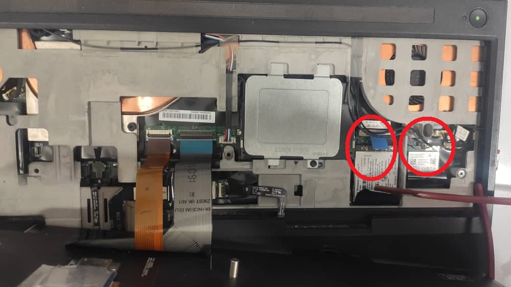

no . based on u tube video I’m just inserted the module in slot under the keyboard of Lenovo P50
if Antenna is required i will buy an antenna!
i can use wlan antenna for em7455?
Seems there is no signal received
No service means No Signal ?
i will buy an antenna! :face_with_thermometer:

i m connected en external antenna from another Lenovo laptop and its is worked for few minute (antenna percentage 20%) :star_struck:
but after restart module is turned off and cant be turned on
