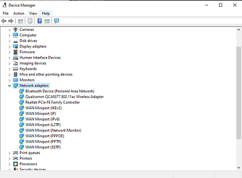

Is the RV50X currently located near you? When connecting it to the computer using a USB cable, do you see ‘Remote NDIS based Internet Sharing Device’ under Network adapters or ‘Airlink USB Serial Port’ under Ports in the Device Manager, as shown in the attached images?
Please share your screenshot with me.
Thanks,

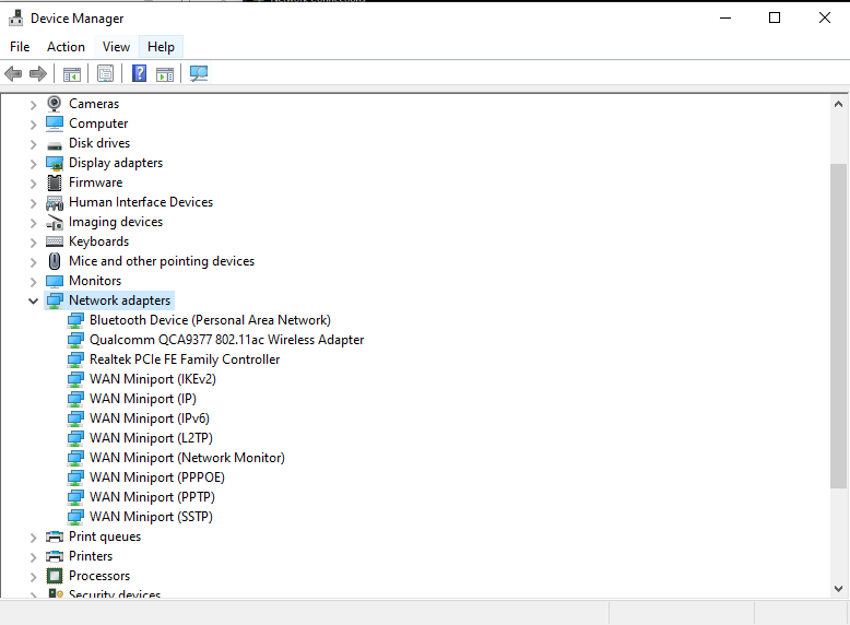

Hi jerdung,
Here are my screenshot photos for your reference.
Hi @pentecostes.philinst,
Have you installed the drivers for RV50X? If not, please download and install the drivers from the following link: https://source.sierrawireless.com/resources/airlink/software_downloads/airlink_usb_driver/#sthash.MBkPp71k.dpbs
Because, based on the screenshots you provided, I can’t see the RV50X interface listed under Network Adapters. After installing, please share screenshots for both Network Adapters and Ports with me.

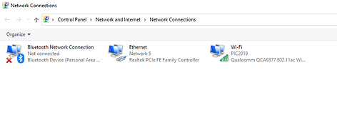

After I downloaded the drivers and installed them, I could not see the “Remote NDIS-based Internet Sharing Device”
Under the Network Adapters.
  1. Are the drivers applicable only on Windows 7? Because I’m using Windows 10.
  2. Please see the attached file for your reference.

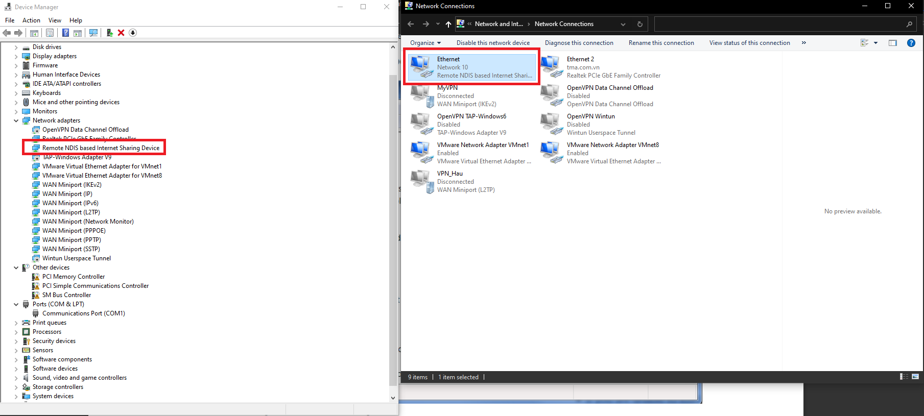

Based on another post (at the following link: Airlink RV50X has a blinking red of led indicator for network and signal - #8 by pentecostes.philinst), you mentioned that you have seen the “Remote NDIS-based Internet Sharing Device” under the Network Adapters. Please continue to follow that post.
