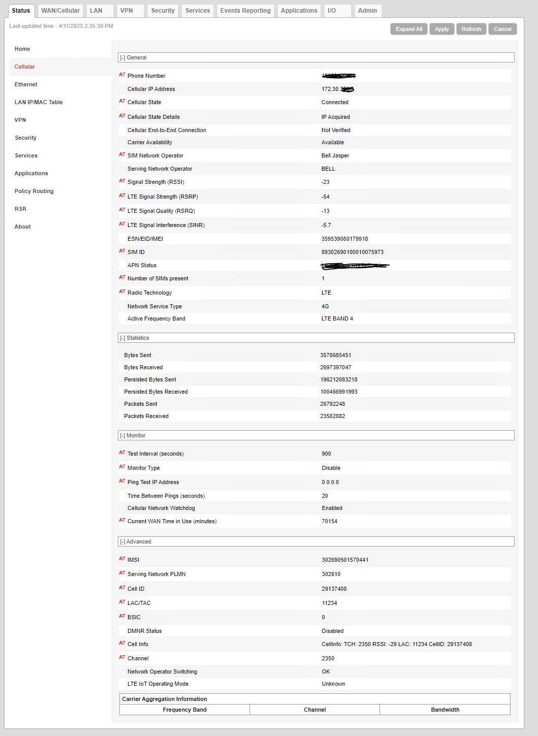

@ a remote location from which you do not receive a response to your web page login, can you get more information from Ace Manager? The status screen. The IP address. The Advanced screen.

I tried to connect and on first attempt after using username and password page stayed blank. I reload page and enter details, and it went through. For this modem firmware is 4.15.1 but we have few that are upgraded to 4.18.X and we are seeing same behavior on all. We are in process to upgrade all to 4.18.X and so far, upgraded 10 out of 52. Please see attached screens.
