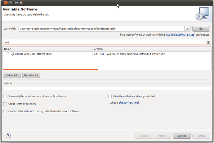

Thanks for information. But could you provide more details?
I am new to Developer studio (Eclipse) so can you write a few steps on how to install Java Development Environment onto Developer studio.
Go to Help > Install New Software
Select Developer Studio update site in the combo list
Uncheck all checkboxes at the bottom left
Type “java” as filter text, in order to find “Eclipse Java Development Tools” in the list.
Check it, click next, follow the steps, and that’s it…
