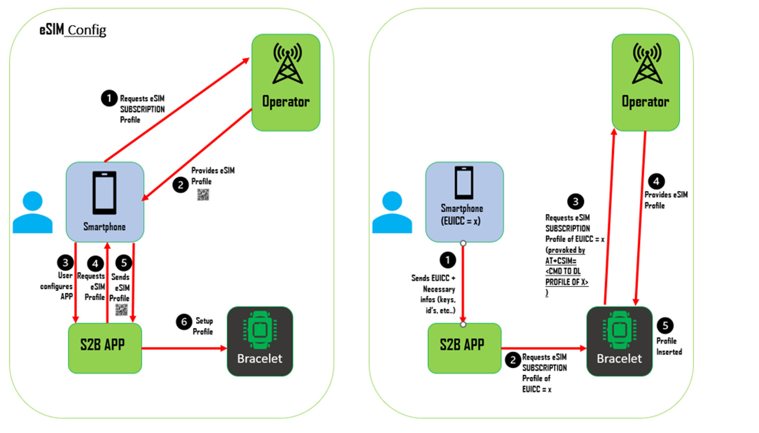

Hi ! I’m new to eSIM and for a personal project, I want to reproduce the behaviour of sharing a mobile subscription between a smartphone and a smartwatch ( as Apple Watch and its paired Iphone do).
For that, I think i should insert or download the eUICC profile of my mobile subscription within the smartwatch I’m creating, but I don’t really find any relevant documentation on how to do that and even if is it possible…
Could someone explain me the high level of what should I investigate, starting from the fact that operators in Belgium allow to insert subscription of a user’s smartphone into its smartwatch.
I think that I should
  1. Download the profile and insert it by myself within the eSIM (with AT+CSIM command)
    OR
  2. use the AT+CSIM= command in order to update records/files of the eSIM and trigger a profile download with the network
Thanks in advance !!
