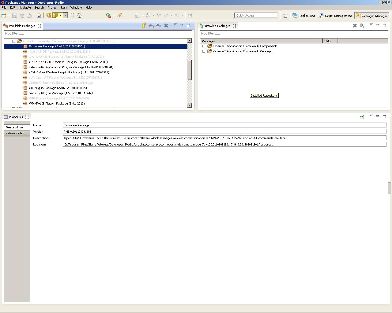

The FW can be found in “Packages Manager” of Developer Studio, right click “Default Sierra Wireless Repository” and select “Refresh”.
“Open AT Framework package (2.36.0.201108300638)” will be listed and you can download it from there, you can find the location path in description.
For info, OpenAT Framework package (2.37.6.201301161050) is the last supported package for FXT001.
