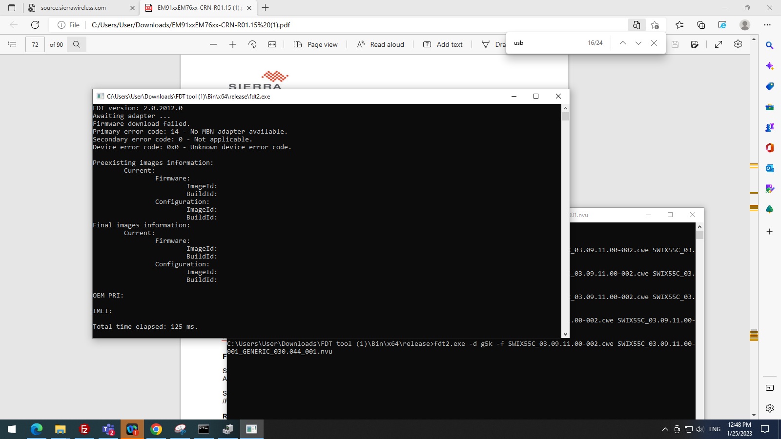

We have downloaded the software we tried commands in cmd but it did’t worked is there any tool to flash .nvu and .cwe file .?
we used fdt2.exe to download the firmware
https://source.sierrawireless.com/resources/airprime/software/fdt/#sthash.HW4Zm2O5.dpbs
Hi
we have installed tool , tried flashing but we are getting below error.
can you please update the steps to flashing .
how about “fdt2.exe -f xxx.cwe xxx.nvu”?

We opened FDT tool we are getting below error .
is there any video reference for flashing for windows.
