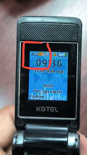

this SIM card was inserted on another phone, the network shows

No, I’m a representative of a cellular company, and the modem is located in another city, at the client’s place. I had the first modem, fixed the problem and gave it to them, now they wanted to launch the second modem themselves, with your instructions, which they did to you a week ago, but they can’t fix the problem on the second modem. the first SIM card was ours, now they use their own SIM card
then it is hard to identify which is the factor causing the problem
