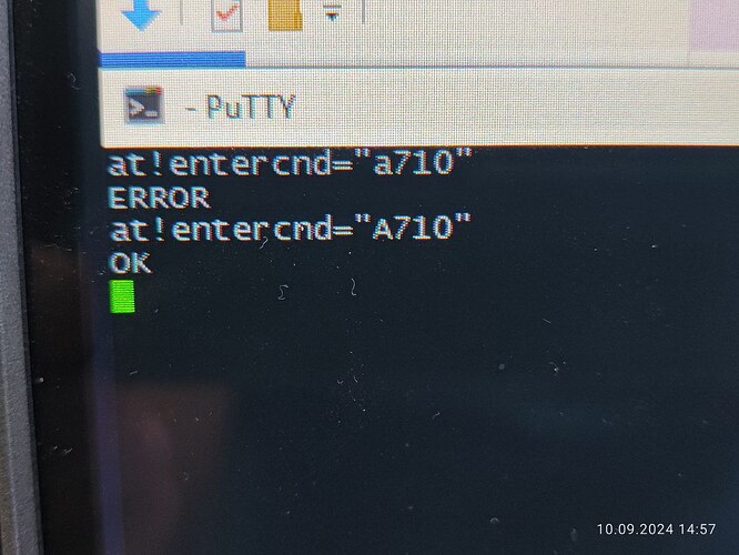

video-1.zip (5.9 MB)
Good afternoon. Our client on the mobile network purchased a new modem, they tried the settings that you sent,all commands were successful, but the modem does not work on the network. Video setting attached. Please Help me
what are the return of
AT!SELRAT?
AT+CgdCONT?
BTW, did you connect antennas?
yes connected antennas
seems the APN is not set in AT+CGDCONT?
Are you using same sim card as the previous ok case?
no, another sim card
