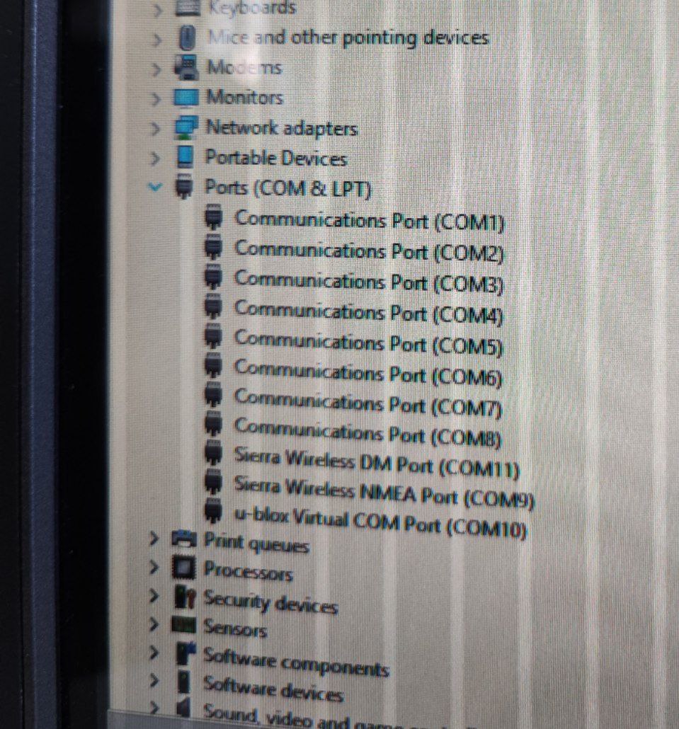

            I think similar actions can be implemented in the putty utility
Colleagues can’t send AT commands
why?
do you see modem port in device manager?
then can you use tera term to open the modem port to type AT command?
