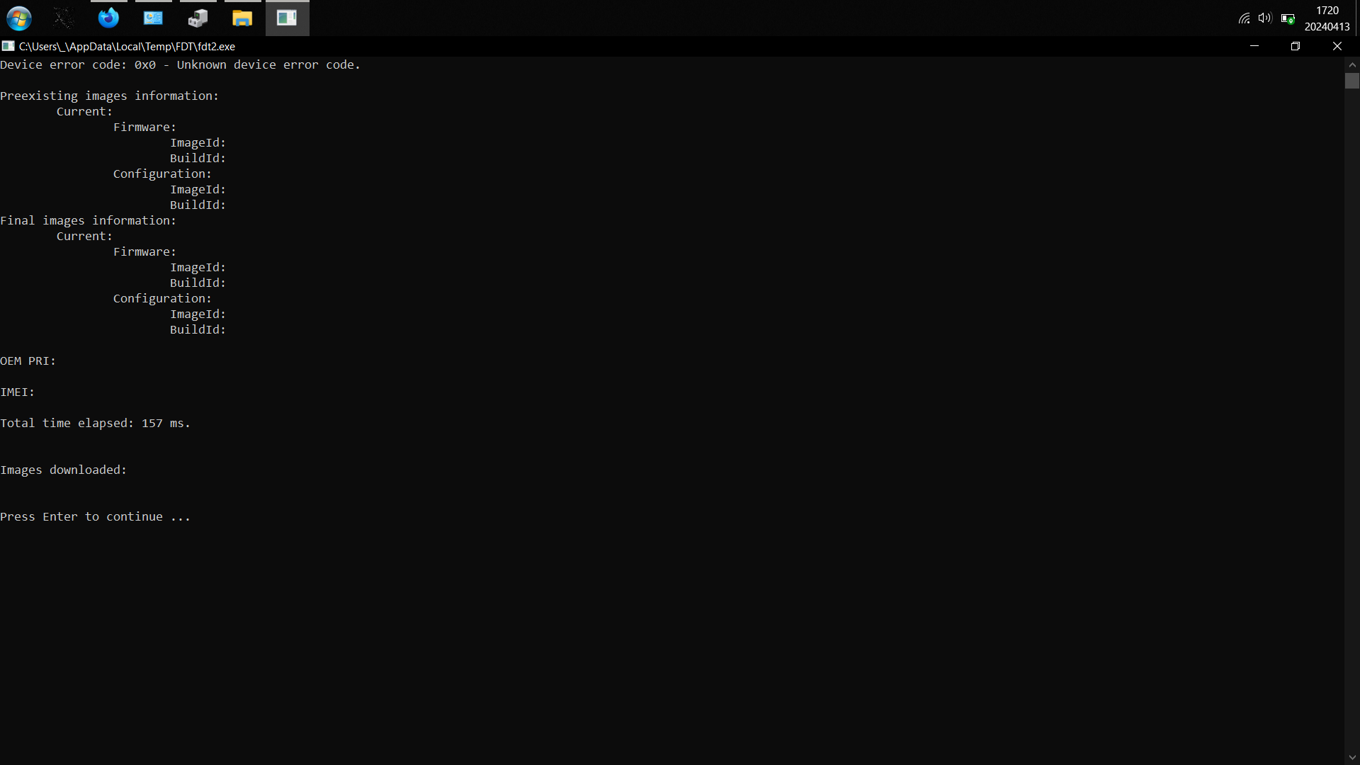

I now started Fdt2 without the arguments and it shows this:
the window which aske for my SIM’s pin disappeared
winows now displays cellular mode in the settings menu, but it doesn’t detect the sim card.
