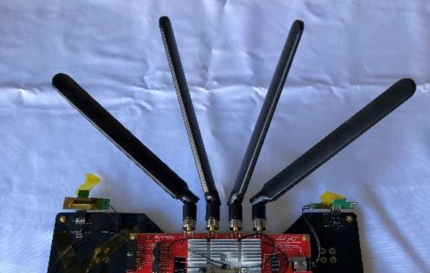

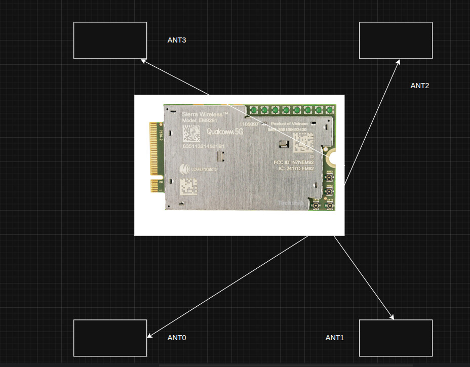

Hi @jyijyi ,
Is Antenna order important?
Do we need to place Antenna0 to Antenna3 like these or we can put in any order for better range and power?
Thanks,
Arti
is there improvement if we change other antena direction?
I remember for EM919x, we would suggest the positioning of the MAIN and DIVERSITY antenna MUST be near 90 degrees in the same horizontal plane to get better polarization performance
