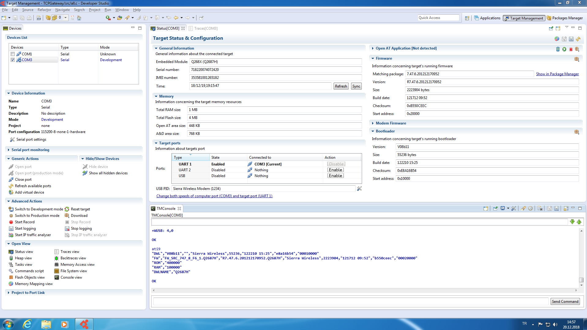

I am using Q268X (Q2687H) Embedded Module and trying to download a simple TCPGatewat application into the module. When I tried to donload the app into the module I am getting a strance error like “ERROR: The target hasn’t enough RAM memory for your application.” as following:
All the information like Firmware Version, Bootloader Version, and etc. of the modem as following:

3 years ago the Developer Studio Framework was 2.35 and the SS of the configuration of Target Management is as following; (SS taken 3 years ago)
Thanks for your help.

Firstly, I’ve installed the “R7.46.0.201107210505-cus-q26e-03.wpk” package via DWLWin and then updated it to “7.47.6.201212170952” via DS package manager. Then an option is appeared in Memory Type as 256Kb. I’ve selected this option and then could be able to install and run the application.
