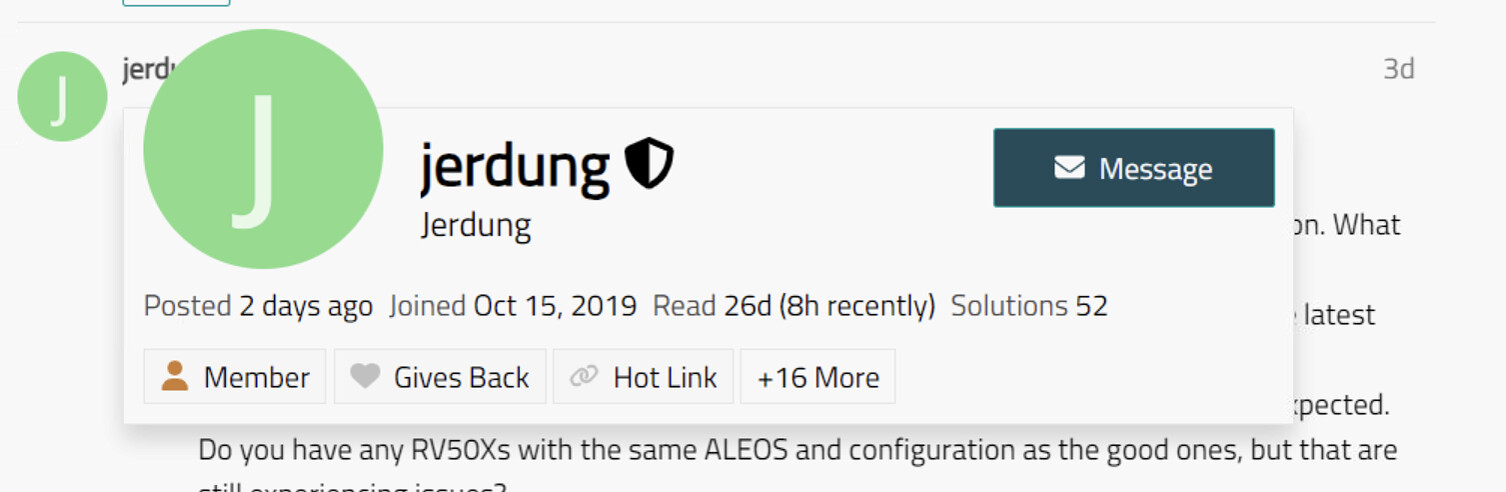

Hi @chrisknoche,
Please share the full log file and template file of the device running the old firmware that works well, and the device running the latest firmware that is encountering issues, via Message as shown in the attached image (click on the name Jerdung and select Message).
