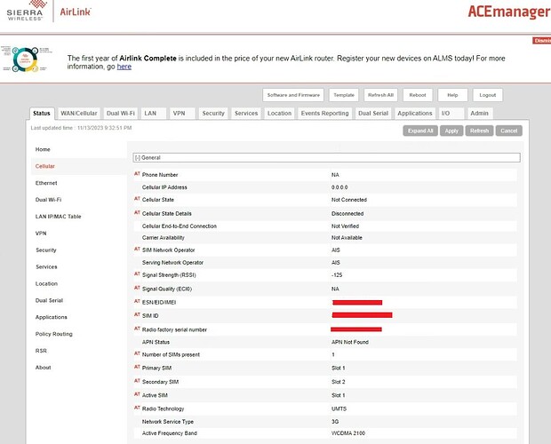

Originally, I bought this for use in North America however our North American factory no longer needed it so we wanted to re-use the hardware in Thailand. I have an active SIM card in Thailand and the Sierra Wireless says unable to connect to any network. I am not sure what else I can try? The cellular service I have a sim card for is AIS.

This is the North America (EM7511) firmware “RV55 Radio Module Firmware for Generic Operators”.
We were NOT able to install the Global (EM7565) firmware version. We also have a new error message “Not Connected”. This error message changed after we entered the override APN “internet”. However, later in the day we realized the APN might actually require a capital first letter “Internet” but haven’t had a chance to test that.

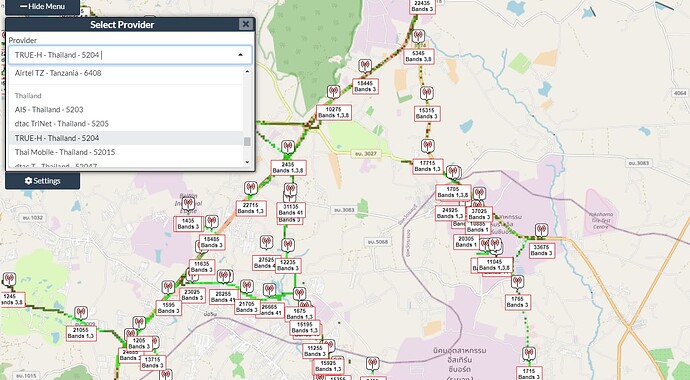

One thing I have found is the area around this factory doesn’t have many AIS towers but has several TRUE towers. I am going to see if I can get a TRUE SIM that supports 4G - LTE.
