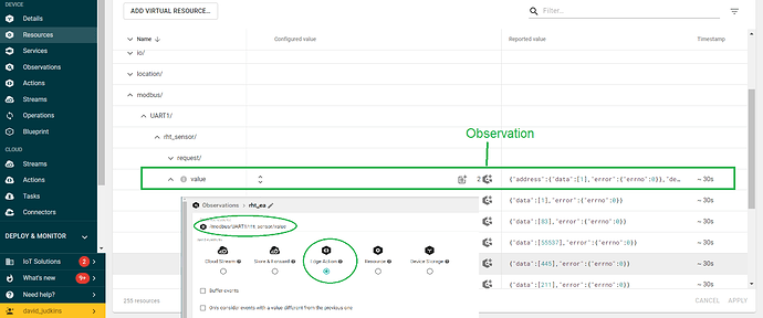

Typically, the data sourced from modbus is stored in an array. Create an observation on the modbus value which in turn will create a stream. If you point your observation to an edge action, you can collect all of the modbus values and use the edge action to read / transform your modbus data and send it in a single stream (orchestrate).
Here is an example observation on a modbus resource that creates a stream.
