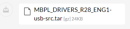

You can install the MBPL usb driver
https://source.sierrawireless.com/resources/airprime/software/mbpl/mbpl-software-latest/#sthash.dfaMo4qO.dpbs
If you have connected the UART2 console, you can type “microcom /dev/ttyAT” to enter AT command
BTW, didn’t you can enter AT command before?
I am not getting the location info
[image]
[image]
[image]
[image]
i believe this one
yes, i have used via VS code terminal where microcom is working. However, I am ok with AT commands. No I can go outside to check the AT commands
