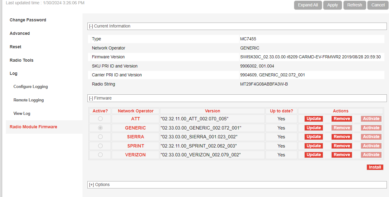

- Please let me know which radio module firmware the RV50X is currently running.

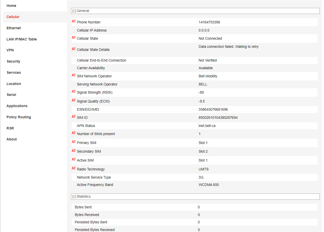

- How did you configure the APN for the RV50X? Was the APN assigned when you inserted the SIM, or did you manually configure it? Please share a screenshot of the Status > Cellular section on the ACEmanager web UI.
Please see below:
APN was automatically assigned when I inserted the sim

Hi @mian.mohsin,
If you have tried a SIM from another network (Rogers) and the network has connected, the issue may be related to your Bell SIM. Please check with Bell network operator to ensure that the APN is correct.
