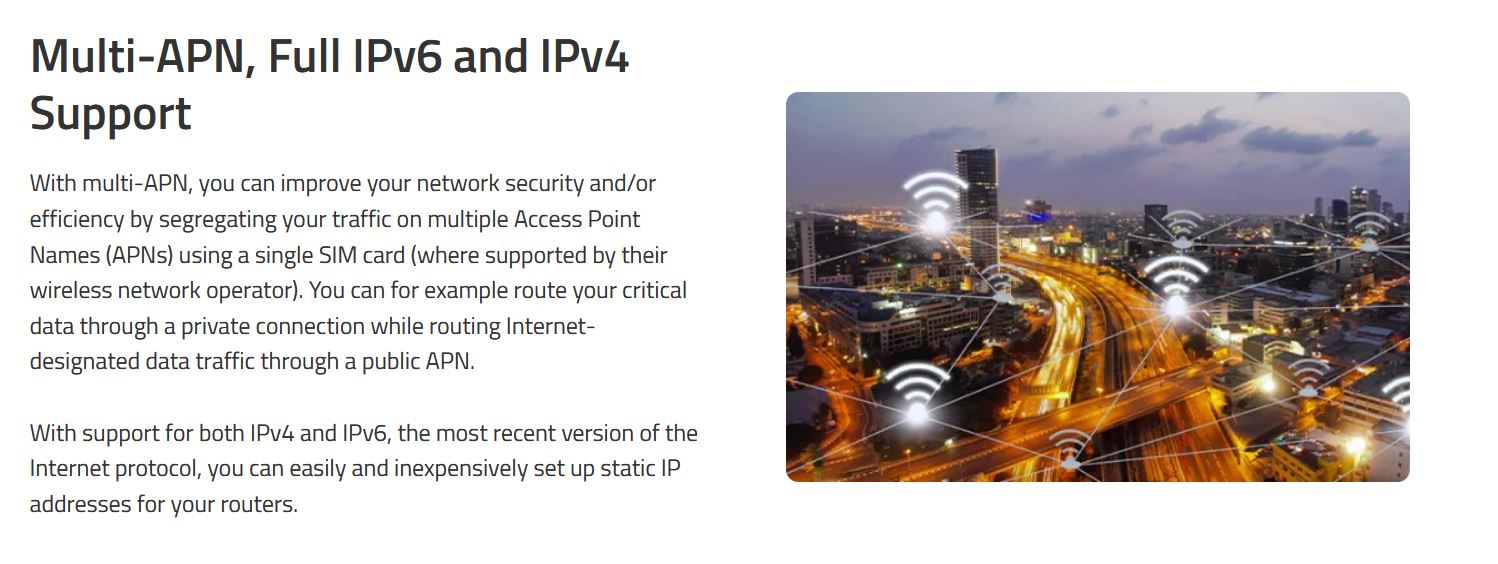

I would like to implement a Multi-APN configuration on an RX-60 modem. From the webpage and image below it would appear that this is possible, but I can’t find any instructions for how to go about implementing this feature. I’ve probably missed it somewhere, but I would appreciate any advice or direction.
If it helps, I am using a Verizon SIM card that I want to connect to both a private APN and a public APN. I’m hoping to route the traffic from each APN to a different Ethernet ports, or in some other way separate the traffic that comes in from the different APNs.

Please refer to Multi-APN Configuration section at the following link for more information:
Configuring Cellular Interfaces - XR60-5.2 - Sierra Wireless
