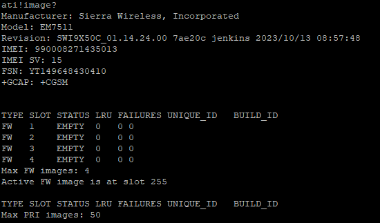

Were you ever able fix this? We are having the same problem with a bunch of 7511s. Attempting to flash the firmware results in either only slot one getting populated, or in a few instances NONE of them get populated and we end up with “Active FW image is at slot 255” and it switches to a really old firmware version.

Which on a lot of them is resulting in no firmware installed after the flash:
A lot of them are now stuck in this state with no firmware, even trying to install a single firmware using:
fdt2.exe -f SWI9X50C_01.14.24.00.cwe SWI9X50C_01.14.24.00_VERIZON_002.064_000.nvu -force
Results in the same thing with no firmware image installed.
