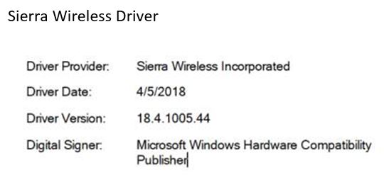

What’s the driver package installed on your Windows machine? This can be checked in “Control Panel”. Was the driver package installed with carrier images? Asking this because there is a SWI feature on Windows that enables automatic image switch. It’s possible that newly updated firmware could be overwritten by previously installed Windows driver package.

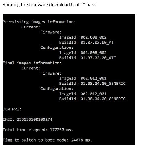

Here are the results you requested. Getting the F/W and Config versions synchronized can be accomplished by programming twice. Can you explain any consequences to behavior of EM7565 if F/W version is release 12 and Config version is release 11?

Running the firmware download tool 1st pass:

Sierra Wireless Driver
Sierra_Wireless_Driver_Version
