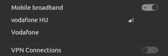

Whenever I start w10 first and do a reboot I am able to use my WWAN without any error, please see attached picture. (1w2l.png) if I start Linux straightaway the I can not make connection with it (picture L.png) and connection looks a bit different.
