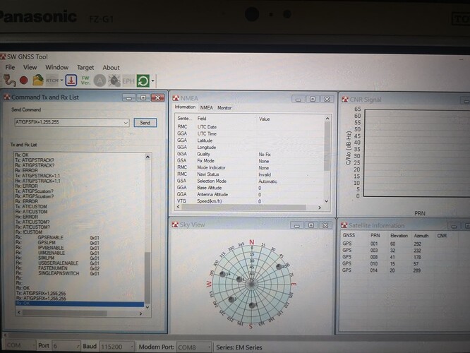

I am trying to use the EM7455 to obtain GPS information using the dedicated GPS antenna port.
Hardware Setup:
EM7455
Taoglas Colosseum MA850 5-in-1 Permanent Mount Antennas
Software Settings:
GPSENABLE = 1
GPSSEL = 0
WANT = 1
After entering AT!GPSFIX=1,255,255 the module fails to determine a fix:
Any help is appreciated,
Casey Gross
Hi @casey ,
According to your description, everything is fine so please tell me what firmware are you using on the EM7455 module? So I can recheck.

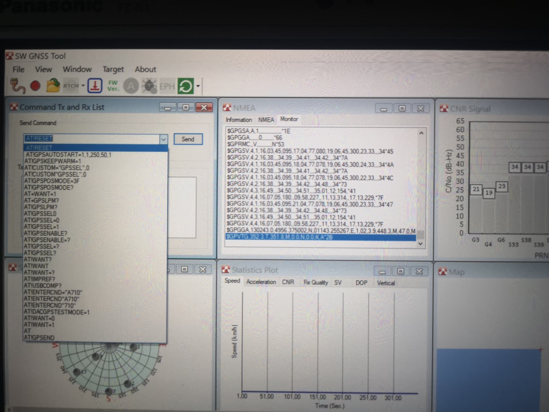

Hello. I have the same problem.
But with MC 7455 on latest Generic Firmware.
With USB composition=9 I can Monitor Satelites with Sierra GNNS Tool. But no fix at all.
With USB composition=8 I don’t even get a NMEA Stream.
But I need also a USB Composition with MBIM because it should work in a simple way with Microsoft Maps.
I blocked some Pins to run the Card in USB Mode on the internal M2 slot.
What way I need to walk to get this running with a generic flashed Module? I also use dedicated Connector and Active GNNS Antenna. I will post a AT Output related to the Initial posting for comparing when im Home.
BTW. The Modem on the other Hand works like a charm. Fast and stable with 150/50Mbit inside a Fz-g1.

Tried indoor and outdoor.
Yes. The mc7455 can supply voltage with At!WANT=1
I can see a list with 14 Satellites but no fix.

Got it!
I think it was AT!GPSPOSMODE=3F
Old value was 0000001
Maybe that’s helpfull for the initial poster.
Just throw everything above and including AT!ENTERCND=“A710” INTO the command line. :wink:
I installed the Windows Drivers by creating a shortcut to the Exe. With the Line I post here following after the picture.
pathto\DriverInst.exe" USBCOMP=9 GPS_Tracking=1 -FWUPDATE=OFF -AUTOFWSIMMATCH=0 -GPS=1 -GPSAUTO=1 -LOCATIONDRIVER=1 -WIN8LOCATION=1
Everything works!
Working Microsoft Maps and Working NMEA on Com 7
