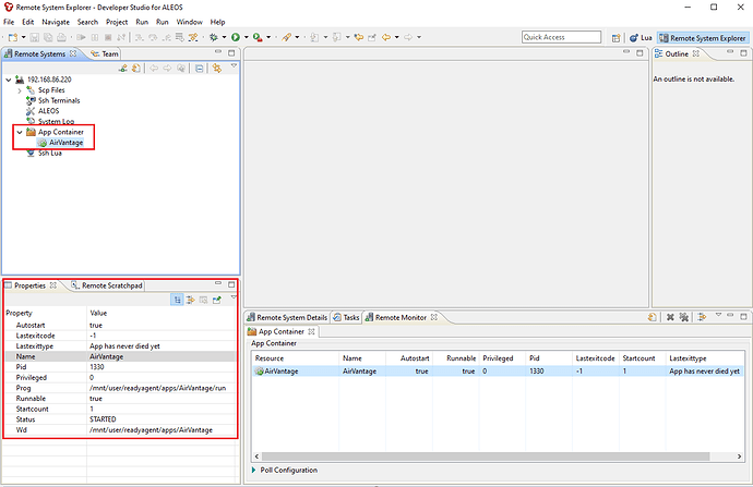

The app you install on RV50 should be listed in App Container. The green arrow in front of the app means it is running. Or you can check Status field in the Properties tab.

I was aware that I can manually start and stop apps from that menu but I need to automate the process, especially as the program will be running remotely and I wont have physical access to be able to make a connection like that using developer studio.
