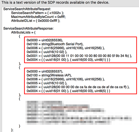

After experiment and document review, it turns out the SPP UUID needs to be set in BC127 configuration.
When setting the SPP UUID to the string specified by Apple, the iOS BT picker can recognize BC127 module.
BUT, since the SPP UUID is changed, not the public used one, then Android cannot setup SPP connection successfully.
When comparing with anther existing dual-mode module, I have found that it employ two attribute records in SDP to allow both Android and iOS
can discover the module.
Could this be implemented in future release?
