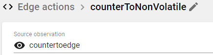

I think I have reproduced the same issue FW 3.0.2 FX30S
Account is skinbase
Blueprint jtTestVolAndNonVol
Device 30099
This one executes
and this one doesn’t
Hello John,
There’s a fix coming for this. We have uncovered an issue which -sometimes- happens when changes are made on a device which was originally aligned with e BP (i.e the device has some diffs made since the last BP was applied)
A fix to avoid this will be introduced in 3.1
A workaround in the meantime is to make sure your device is aligned with a BP (in order to do so you can switch it to another blueprint and switch it back to the desired BP)
