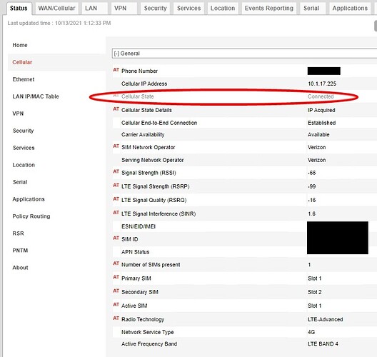

Wondering if there’s a specific SNMP OID available for the info circled on the attached picture. The downloadable RV50 MIB file doesn’t seem to have this important piece of data. Any alternative signals with similar content would work as well.

I tried to load MIB and couldn’t find this info.
If your cellular is LTE and up for WAN link, you can alternatively check wanIP (OID .1.3.6.1.4.1.20542.9.1.1.2.301).
wanIP displays 0.0.0.0 → status is not connected
wanIP displays your cellular IP → status is connected.
