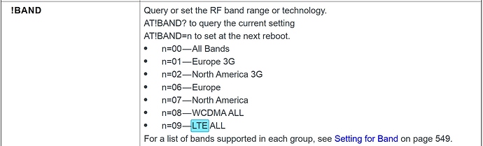

You can lock RV55 into LTE through Airvantage.
Go to Configuration-> WAN/Cellular/Cellular/General/Band Setting/Setting for Band: 09 on Airvantage. Then Apply all changes and restart the RV55 device to take effect.
I have attached the screenshot for your reference.
