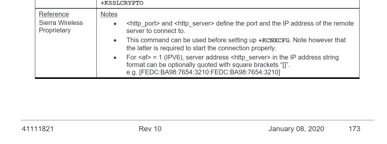

Hi,
Since I have put AT+KCNXCFG=1,“GPRS”,“good APN” it’s now working.
Now, even if I power OFF then power ON the board, it’s still working (without entering command KCNXCFG)
In the AT command I can see this (my developement started with module fw version 4.3.9):
The modem shall works even if the command is not entred.
Btw, I now have to find a way to know precisely how to fix it.
To try to reset the modul I have dowloaded the firmware 4.3.9.0 and it’s still working.
How can I do to restart the module from scratch ?
