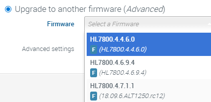

Hello. I tried to downgrade a HL7800 module from firmware version HL7800.4.6.9.4 to HL7800.4.4.6.0 via the airvantage website but it didn’t work. It says “Upgrade failure [No package available]” even though I chose the full package for HL7800.4.4.6.0 from the list of available firmware. Is there any workaround for this?
I need to downgrade it for comparison test and the module is in a remote location, that’s why I performed a FOTA downgrade. Are there any other methods for downgrading other than this? Thank you in advance for any support.
