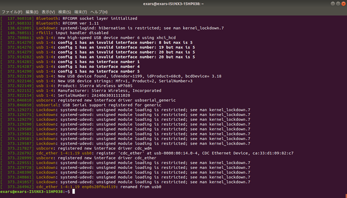

I have restart my computer and dmesg after I tried to connect “ssh root@192.168.2.2” and I got this.
the board that update uncompleted
connect with mangoh yellow board
the board that update completed
first could you please help me to fixed the board that update completed to have usb port back?
in the board that update completed is doesn’t have this 2 lines.
[ 373.046810] usbcore: registered new interface driver usbserial_generic
[ 373.046850] usbserial: USB Serial support registered for generic
you need to compare the UART2 debug message and see why there is difference
