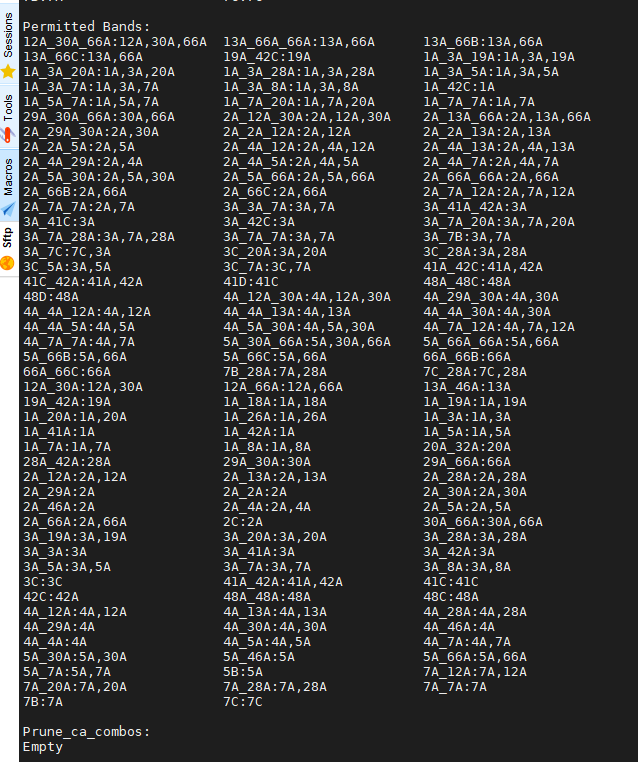

But it list 41D:41C in the AT!LTECA?

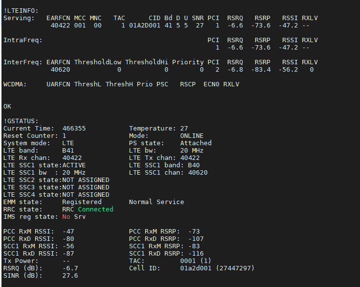

It is our own network simulator. The UE connects on 2CA but not on 3CA. In wireshark, the UE sending capability which does not include 41D:41C
