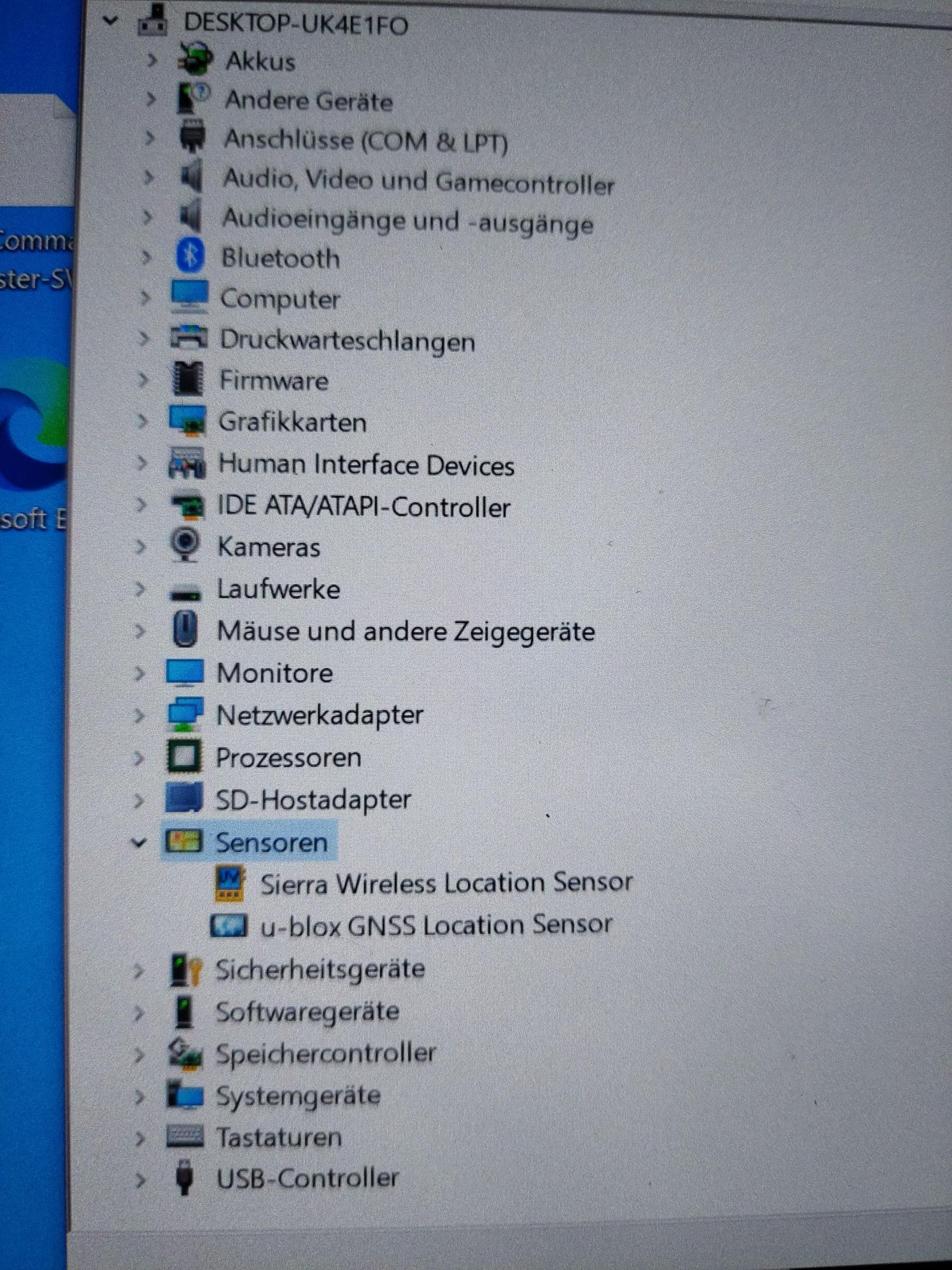

Hi @jerdung,
I already installed this driver package, now I did it again. As you can see, there is no Modem showing in the Device Manager. But the Modul appears in the Sensors Tab, so its attached to the system and working (at least it looks like).
I’ve insert a SIM Card, and the card works (Checked with my Mobile)
Any Ideas about this?
Thanks

Hi @jerdung,
Modul is connected to the mainboard via PCI Express NGFF (M.2), not over USB, but if there would be a problem with the connection, the Position sensor side of the module had to disappear as well.
I have the same HW setup 4 times, but on every device it shows the same: Modem is missing from the device tree.
