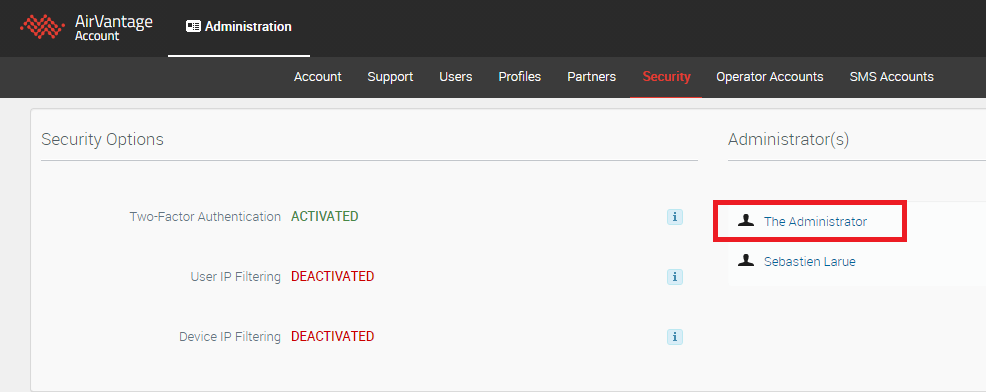

That is because those activities are not enabled for your account. You can check your current assigned profile by clicking on Navigation button on the top right corner > My account > Profiles > User Interface.
You then need to contact your administrators to enable those activities for your account. You can see administrators by navigate to Security tab under My account.

  2. If it is not. You can check your profile to see whether the options are enabled on your account as below.
The account needs the permission from Administrator to get the options. Please contact him as below
