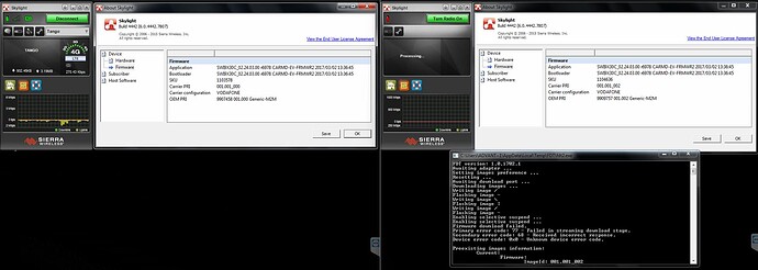

Hi everyone,
I have two computers, exactly the same (same software and hardware) - see attached picture . The only difference is the Vodafone firmware version:
- 001.001_000 which works (even on two other computers I have
- 001.001_002: with this firmware I can’t connect to 4G/3G/LTE
I am thinking that since it’s the only difference, if I can install the older version of the firmware, it should work, since it’s an exact replica.
But when I try to install this firmware: 9999999_9904930_SWI9X30C_02.24.03.00_00_VODAFONE_001.001_000
I get the following message. Can anyone help me install this older firmware?

Enabling selective suspend …
Firmware download failed.
Primary error code: 77 - Failed in streaming download stage.
Secondary error code: 68 - Received incorrect response.
Device error code: 0x0 - Unknown device error code.

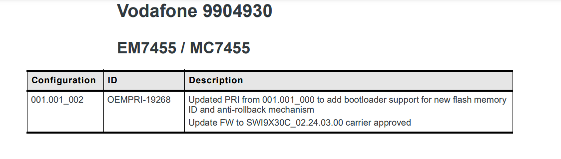

PRI release note says there is update on the new flash id:
what is the return of the followings on the module with 001.001_002

“MT29F4G08ABBFA3W” is new flash, you cannot apply the old FW/PRI
Ok thank you for the feedback.
Why isn’t it working with this new configuration?
