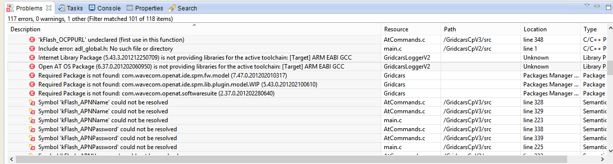

once all was selected, I tried to build his project but I still get the errors:
include error: adl_global.h: no such file in directory
and a few package missing errors. I attached an image of my errors.
I tried cleaning the project for a fresh build but it did not make a difference.
could someone please point me in the right direction? I dont have a lot of experience on eclipse based IDEs
