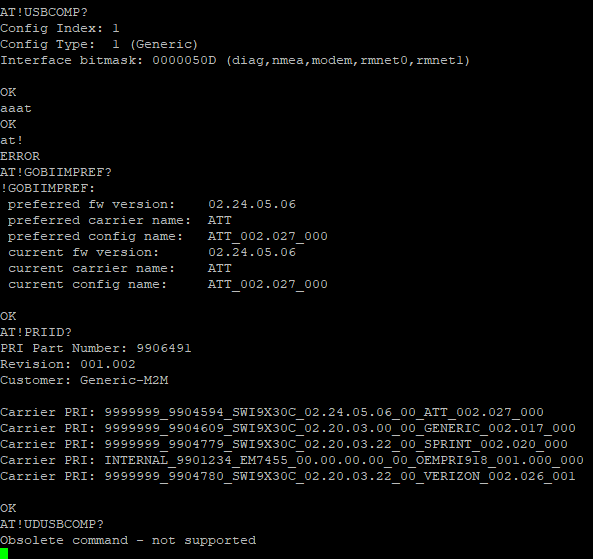

Hi,
I got eth1 and 2 from MC7455 but with no IP and internet connection.
Regard,
JB
mlw
2
JB,
All you should need to do is send the below command to the unit and the interface should populate itself assuming you have network manager on.
at!scact=1,1
