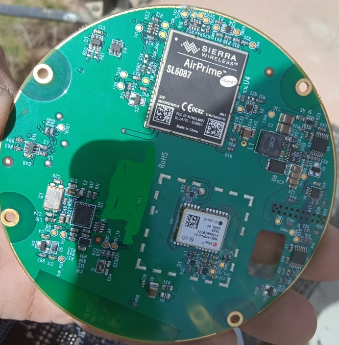

A SL6087 module used in marine lanterns is used to transmit lantern status. Most of the time, the connection fails.
However, now the SIM cannot be dialed, but it works in a mobile device
how to solve this issue
