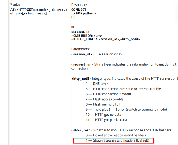

I have found the answer - all I needed was to add “,1” at the end of the KHTTPGET command, i.e
AT+KHTTPGET=1,“/api/test”,1
and the response comes back
