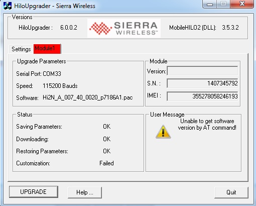

Hi all,
i’m trying to upgrade HiloncV2 through host CPU, i follow SierraWireless(SW) guide and it work except for Customization step.
I already try with v8.00 and 7.40 with same result.
However upgrade process seems had done, but when i try to comunicate with Hilonc, it at power up sends:
+KSUP: 0
now if i send any AT command HiloncV2 answer correctly but after the first it hang up and it never answer to any other AT commands.
This is the end of upgrade log:

28/04/2015 16:37:13'630 MOD1 AT command retry by restart module...
28/04/2015 16:37:13'630 HUM1 UserMessage [142] : Detect process encountered an error!
28/04/2015 16:37:35'408 MOD1 Restart module -> (Waiting for 7 s)...
28/04/2015 16:37:42'415 ATC1 Detect Module at COM33
28/04/2015 16:37:42'425 ATC1 Checking COM33 @ 115200 bauds
28/04/2015 16:37:42'625 ATC1 W (1) 00
28/04/2015 16:37:42'635 ATC1 W (3) 41 54 0D
28/04/2015 16:37:42'815 ATC1 R (6) 0D 0A 4F 4B 0D 0A
28/04/2015 16:37:42'815 ATC1 W (8) 41 54 2B 43 47 4D 52 0D
28/04/2015 16:37:45'591 HUM1 UserMessage [144] : Unable to get software version by AT command!
28/04/2015 16:37:45'591 PACF Deleting temporary files...
28/04/2015 16:37:45'591 PACF Delete file : HI2N_A_007_40_0020_P7186A1_HU.PARAM
28/04/2015 16:37:45'591 PACF Delete file : HI2N_A_007_40_0020_P7186A1_HU.CLA
What’s happened? and how can i recovery the devices?
Thanks
Marco
