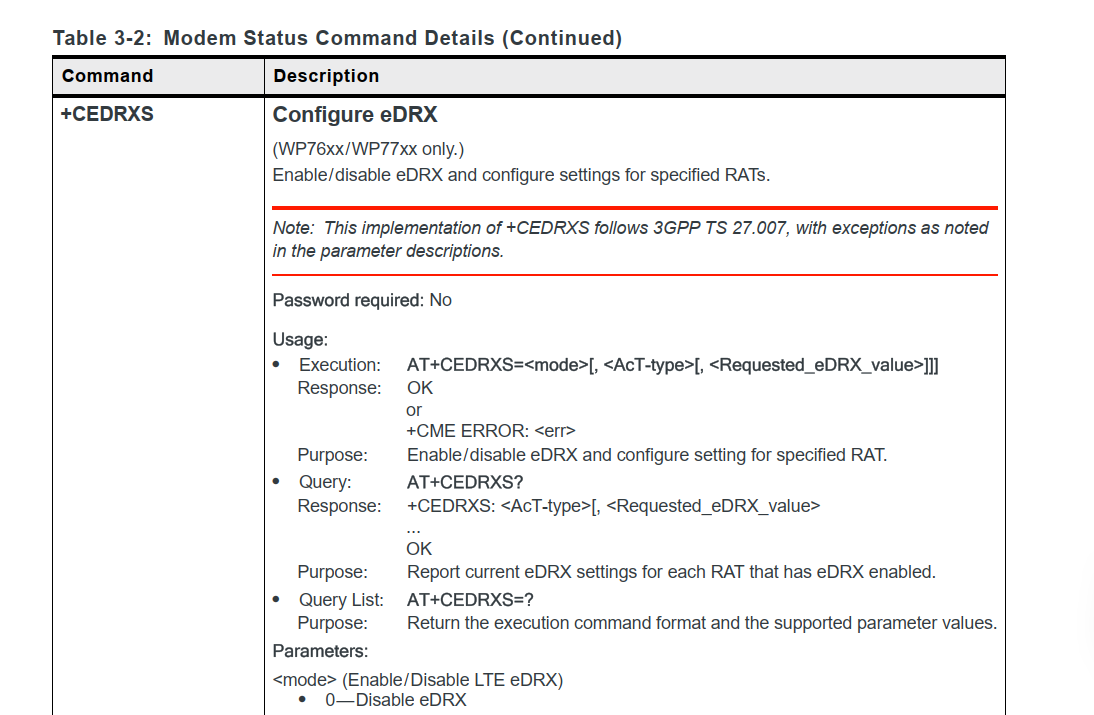

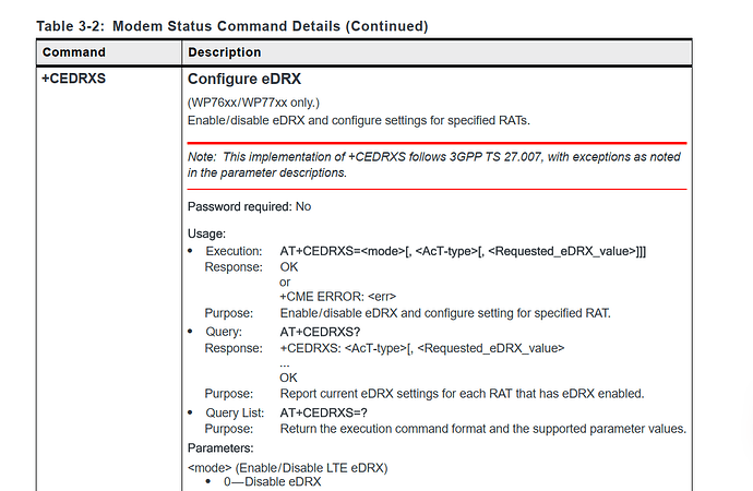

I can’t find any description of what the AT+CEDRXS does???
Yes, I have downloaded and review the WP77xx AT Command guide, but it mentions it, but doesn’t tell you what it does, if you need it, or how to configure it.
