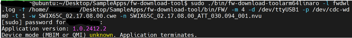

Hi,
I upgraded EM9293 FW in Linux OS and used MBPL_SDK_R44_ENG5-fwdwl.bin, but it always failed.
The device is arm64 architecture
Does anyone know what parameters I should use?
The following picture shows my upgrade failure screen and the log as attachment.

how about using the following?
owner@ubuntu:~/QMI/MBPL/MBPL_SDK_R28_ENG5-fwdwl.bin/SampleApps/lite-fw-download$ sudo ./bin/fwdwl-litehostx86_64 -l fwdwl.log -f /home/owner/Desktop/EM92_FW/R1/ -m 4 -d /dev/ttyUSB0 -p /dev/cdc-wdm0 -t 1 -w SWIX65C_02.13.08.00.cwe -n SWIX65C_02.13.08.00_GENERIC_030.047_000.nvu
Still can’t upgrade
is your module in MBIM mode?
Just did a test in Ubuntu PC, no problem is found for my EM9291 module:
owner@ubuntu:~/QMI/MBPL/MBPL_SDK_R44_ENG5-fwdwl.bin/SampleApps/fw-download-tool$  sudo ./bin/fw-download-toolhostx86_64 -l fwdwl.log -f /home/owner/Desktop/EM92_FW/02.17.08.00/ -m 4 -d /dev/ttyUSB0 -p /dev/cdc-wdm0 -t 1 -w SWIX65C_02.17.08.00.cwe -n SWIX65C_02.17.08.00_GENERIC_030.081_001.nvu

Yes, module is in MBIM mode.
We are not sure whether it is a problem with the ARM64 architecture or kernel.
We also found that although the MBPL R44 USB driver was executed, after make → make install, the related drivers were not mounted, such as cdc-wdm, and all drivers needed to be mounted manually.
have you tried with Ubuntu PC first to isolate if this is module problem?
@jerry.li , did you find a solution to this? I’m encountering the same issue when I try to download any firmware on my EM9293.
have you tried with Ubuntu PC to isolate different factors?
