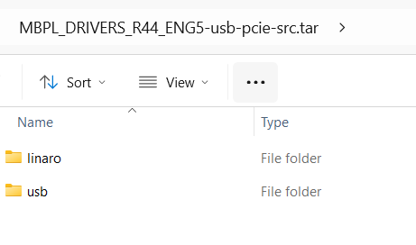

hi @jyijyi i have checked each folde i did not seen any readme.txt file only .ko files are there
jyijyi
September 4, 2025, 6:09am
29
you have downloaded the wrong file, it should be “MBPL_DRIVERS_R44_ENG5-usb-pcie-src.tar”
yes, my bad..now i have downloaded correct one
