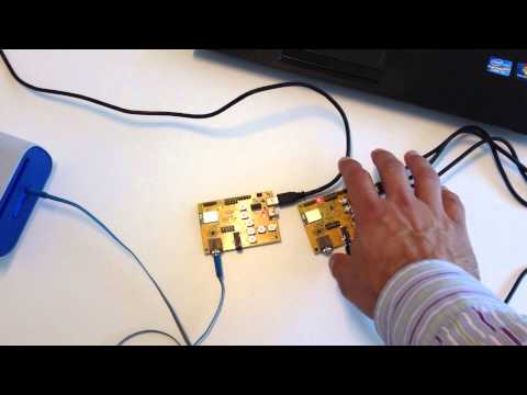

I found an earlier data sheet by Blue Creations in which streaming audio between two Discovery Boards is described.
The document is: Blue Creation BC127 Discovery Board (BC127-DISKIT-001) Manual 1.0
On 7th page (no page numbers) title "Getting Started (2 boards) " the images shows two Boards and the first paragraph would suggest it is possible to stream audio and data between the two boards.
Quote: " You can use two BC127 Discovery Boards and have them connect to each other establishing a closed system that supports music streaming, voice calls, and bidirectional transparent UART forwarding."
End Quote.
Further on the next page are the instructions to do the audio streaming. ! (which is what I want to do)
Quote: "Streaming music between your BC127 Discovery Boards
  1. Connect your audio device to your Source Discovery Board using the STEREO MIC jack plugs.
  2. Connect your headset to your Sink Discovery Board using the AUDIO OUT jack plugs.
  3. Press PLAY/PAUSE on either device to start music streaming. Press PLAY/PAUSE again to stop it.
  4. You can adjust volume using the VOL UP/VOL DOWN buttons. " End Quote.

Here is another link to a youtube video showing that streaming audio between two discovery boards is possible.
