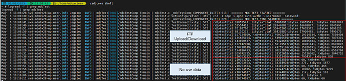

I got data usage used by host pc and legato system.
use data on pc and legato system.
use data only on legato system. (disable host pc’s Sierra Wireless Mobile Broadband Network Adapter)

// Get data counters
LE_ASSERT_OK(le_mdc_GetBytesCounters(&rxBytes, &txBytes));
latestRxBytes += rxBytes;
latestTxBytes += txBytes;
LE_INFO("rxBytesTotal %" PRIu64 ", txBytesTotal %" PRIu64 "rxBytes %" PRIu64 ", txBytes %" PRIu64,
latestRxBytes, latestTxBytes, rxBytes, txBytes);
LE_ASSERT_OK(le_mdc_ResetBytesCounter());
