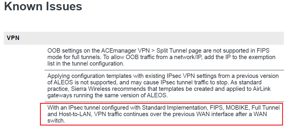

Hi btallon,
All I can explain is that when you switch Cellular to Wifi, the WAN interface also switches from Cellular to Wifi. But somehow, the IPsec tunnel was maintained on the previous WAN interface after the switching (4-5mins). Here is the known issue I found in ALEOS release note 4.12:
If you still face this issue, please try to update to the latest firmware and try again.
Note: On ALEOS 4.14, some users in this forum reported that they faced some connectivity issues with Verizon sim. If you use this sim, please update to ALEOS 4.13 via Airvantage.
